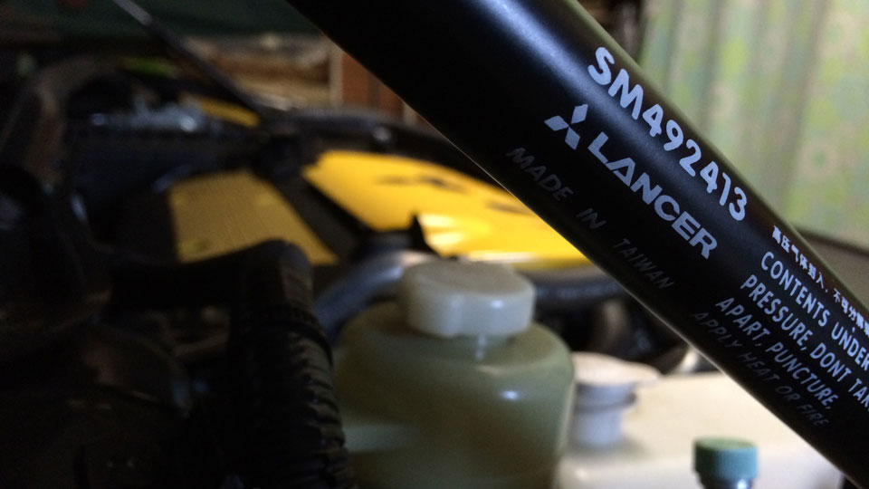

Okay got mine today, and just installed them.
Look and work great but there was a couple of minor problems.
First you need to undo both bonnet bolts which throws the alignment out, remember with the coupe it only had one bolt point there so it wasn't an issue. But I got them fitted and aligned pretty good for now.
Second issue was the lower hole is too big IMO and could lead to damage if it pulls through with wear and tear so I added a washer on the under side which didn't come with the struts.
Over all well worth it for the cool factor of self lifting the bonnet, but in the unlikely event the fail the old bar/strut is still in place. Still annoyed Mitsy doesn't include gas struts as standard on more cars, it would cost them next to nothing to do it in the factory. I remember my parents having an old Torana with a spring loaded system some 30 years ago like many cars of the day even my 76 Celica has a bonnet designed to be vertical when up with a tiny brace in the corner to stop it falling down.
If they found time to design the sedans boot to have gas struts, not to mention the sports hatch like all hatch backs but not the bonnet for less than $100 retail?
Oh and BTW I went for the $99 ones in Brisy on eBay.
