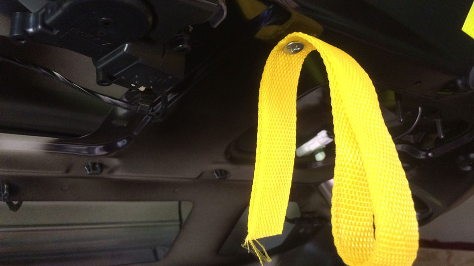

My solution is old school, I'll post when I have it on.
Postby Lancer1993 » Wed Nov 11, 2015 11:54 am
Told you, old school!
There was an existing hole so no drilling needed, just a small bolt and some strapping!
