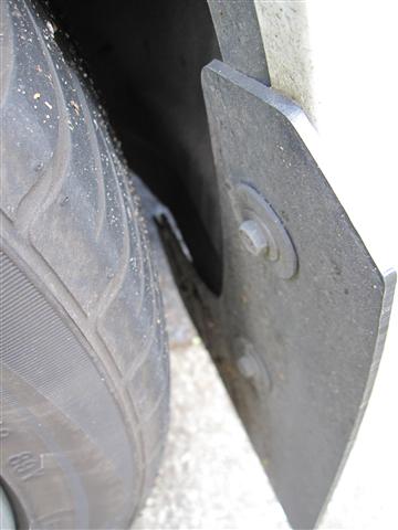

Here is a pic o f the rear mudflap screws: Image
The main two are visible and probably don't need much alteration at all (lengthening of the holes with a drill bit).
The last screw which is a bit hard to see, you can get away without drilling at all and don't use their L- connector to create a screw point for it... doesn't really fit the sportback and will stick into the wheel too much.
What I did was just screw into the plastic guard itself. Hard to take a pic though. So:
||====[spacer]====> Guard
