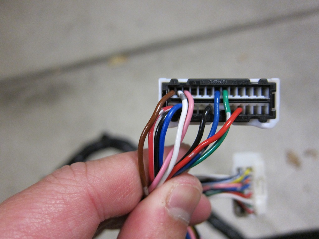

I was hoping I could trouble you for just a little more help with this wiring if you have that loom nearby could you post a few more photos? Showing both sides. I can clearly see one side but am guessing a little with the other side or if it's easier a little hand drawn diagram showing which hole has which colour (could you show the silver flecks on the wires)

here are two more pictures you requested. This shows clearly where each wire goes as I've taken one from the top view and one from bottom view.
Only problem I see you having are the black wires. Both have silver flecks on them.

ofey wrote:Only problem I see you having are the black wires. Both have silver flecks on them.
It prbably doesn't matter. both wires most likely do the same thing, both could be a negative connection and it wouldn't matter which black wire goes into which slot.

Postby Newton1! » Thu Apr 28, 2011 5:50 pm
Got it back together,, no Bluetooth or reverse camera.

Postby Newton1! » Sun May 01, 2011 8:18 am
Alright everyone, took me a few days but got the reversing camera going :D
Still haven't got Bluetooth. The phone button (on screen) under the hard menu button has disappeared :cry:
Behind all the secret menus the Bluetooth settings exist but not useable.
The phone doesn't recognize a Bluetooth.
So I spoke to dealer who tells me they would "probably" just order a new MMCS at an insane price because they are not serviceable.
I have sent an email to the OEM division of Parrot who I understand built the Bluetooth for Mitsubishi. Will wait to hear from them.
So I am stumped. Any thoughts?

Postby ofey » Sun May 01, 2011 8:24 am
So if this is a new car, this should be covered by warranty.
Even if you bought a demo, this should still be covered.
I don\'t think the fault lies with the MMCS but with the wiring loom.
as you have said, the hidden menus show the MMCS\'s BT hardware is detected.
Also, it is untrue that MMCSs cannot be serviced. Mitsubishi dealers can send the MMCS back to Kenwood Au in NSW on your behalf. They do a warranty swap replacement.
It\'s strange though that your BT is made by Parrot.
The ones in the older cars like mine are made by Johnson Controls.
