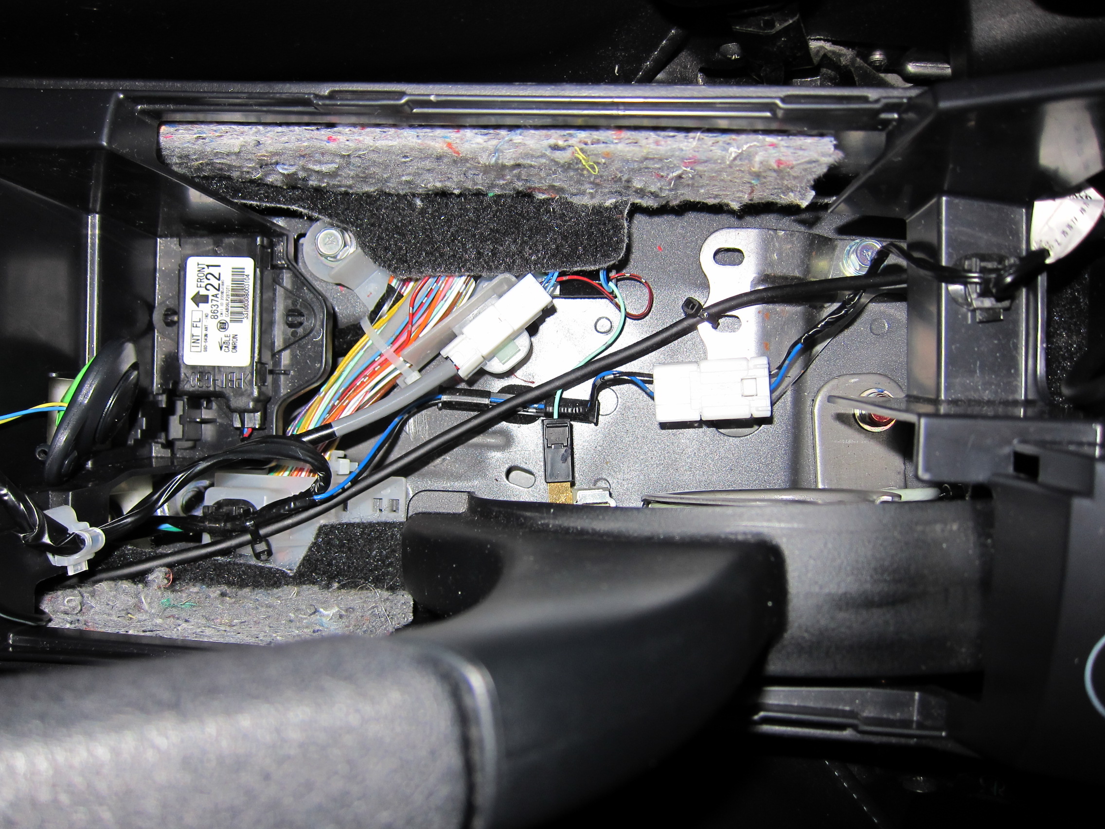

Here's how the wiring under the cup box is on my NA Lancer

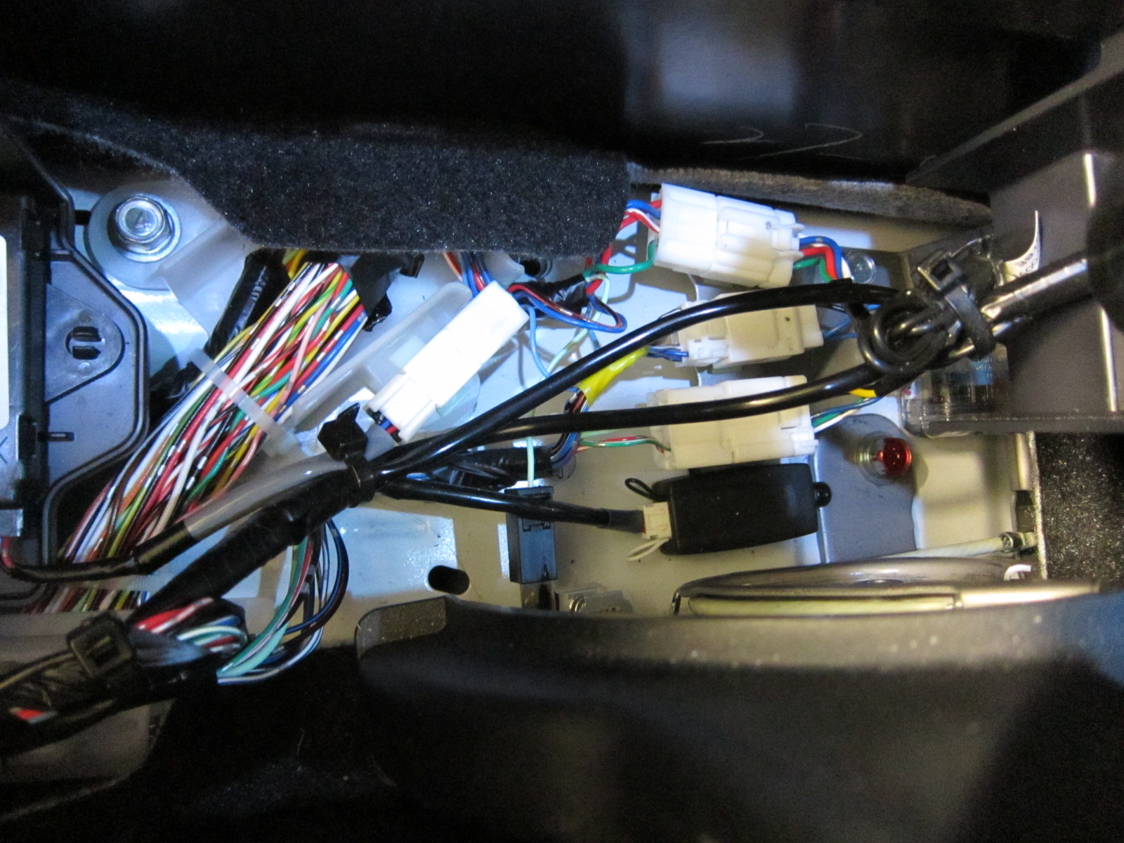

Here's how it looks like under the Evo MR's:
Here's the plug into the switch:
We managed to ascertain that the yellow wire is ACC. So it only shows 12V when the car is on.
This would be a safety check preventing you from leaving the heater on when your car is off *forgetful much?* and eventually setting the seat on fire on a warm summer's day.
We've also ascertained that the smaller gauge wires are tapped straight into the wiring from the 3 plugs on the front panel like AFS Off etc on the Evo and back of the blank coin section on the NA.
This would mean it's just a tap for power to light up the buttons when you switch them on.

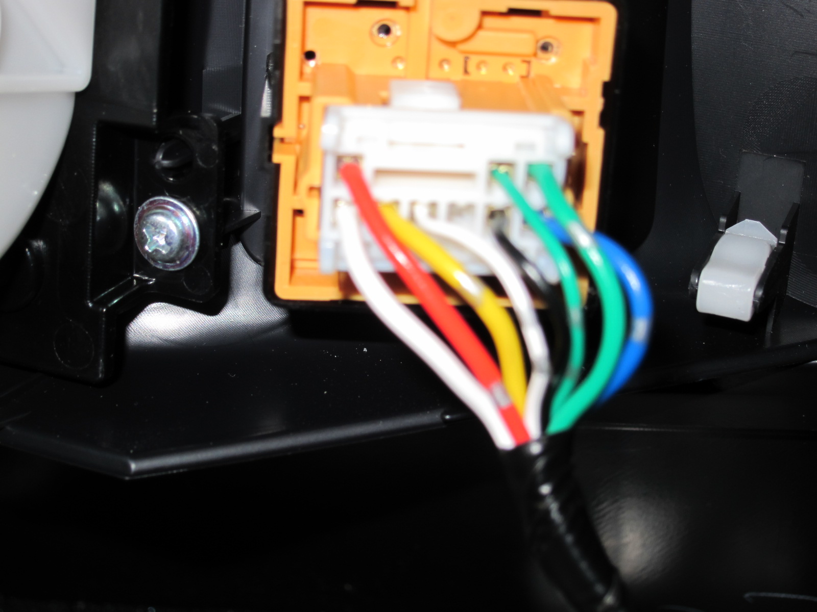

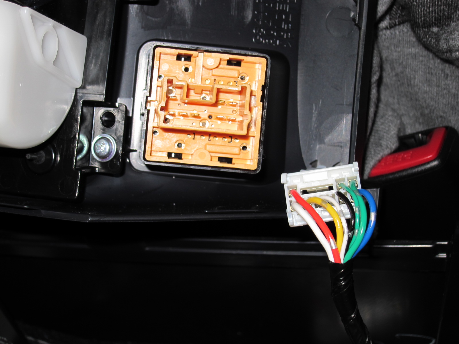

So the remaining thicker gauged wires Red White Blue and Green I suspect is go and return for current (since the switch would be inline) when the heater. But yet to figure out what is what here.
Here's the plug out of the switch (so you can see which wire goes to which pin:

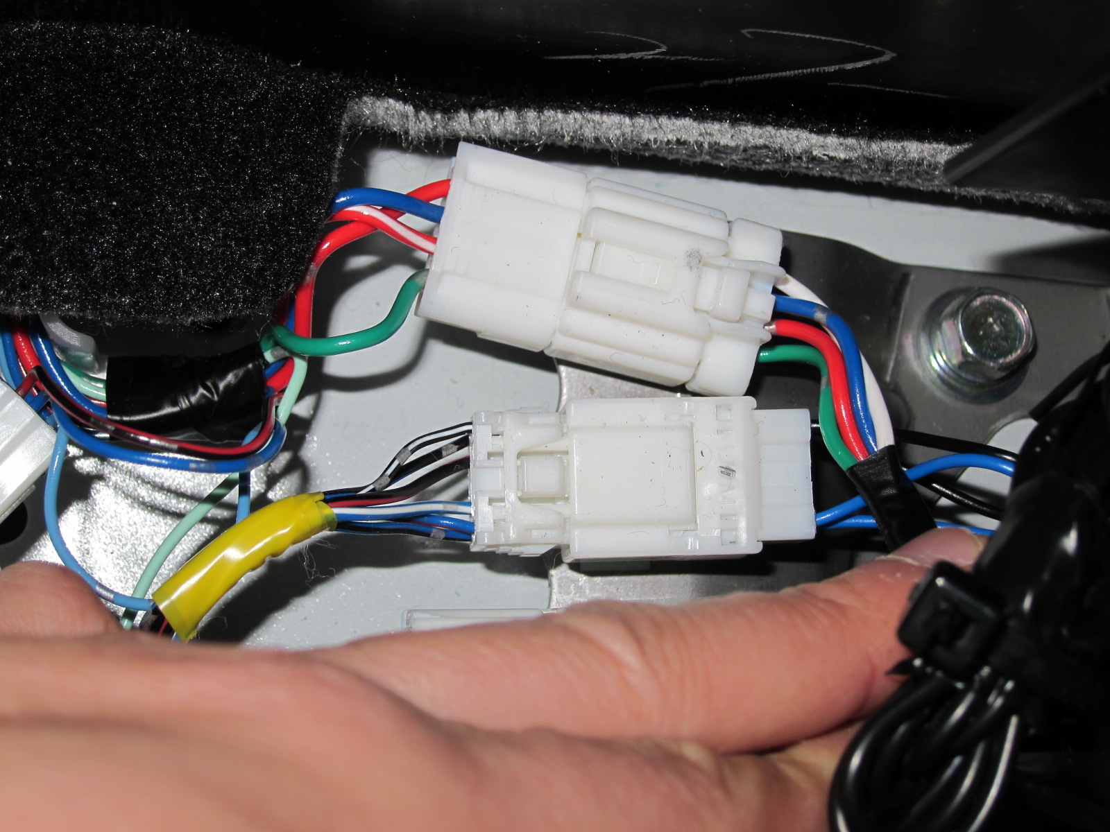

Here's where some of the thicker gauge wires go:
