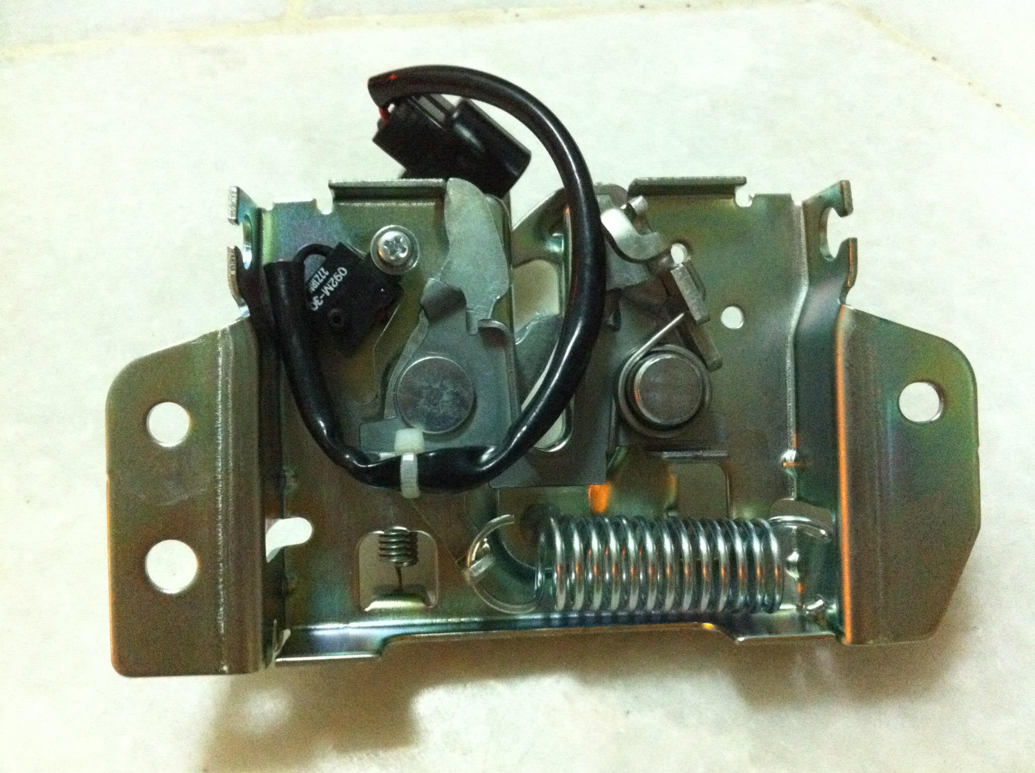

Above is a capture of a hood opening mechanism included extra cable (black) for those who have the stock Mitsubishi Alarm system with their vehicle. (this detects if the hood is being opened while the car is locked)
the connector looks similar to the fog lamp connector. so obviously check your plugs.
This would be a good starting point.
Ok, so I've gone to have another look at it tonight. I tried Unpluging the 2-pin power connector in the front-centre from the Fog Light power connector and the problem goes away. As soon as I reconnected it, it came back.

CVT. There were two unused plugs.
1 near the hood opening mech, which based on the above, I think might be for an alarm, and another half way down the radiator as you said.
I tried the one near the hood, which is probably what is causing the problem; as the one near the rad certainly matches up with where the instructions say to route the cable better. However, the connectors were different and didn't fit together. I might have to cut the cables and change the header on it perhaps.

that is because that plug is meant for a hood open/close sensor. Foglight plug is hard to find but it is definitely there.aeonx wrote:This is what the other connector looks like, its near the hood opening mechanism, and fits perfectly; but once its connected it gives the Close Hood warning when starting the car. [img:73ebe0cca1]http://i62.tinypic.com/2lc8fw9.jpg[/img:73ebe0cca1]
