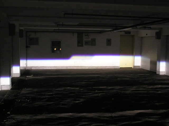

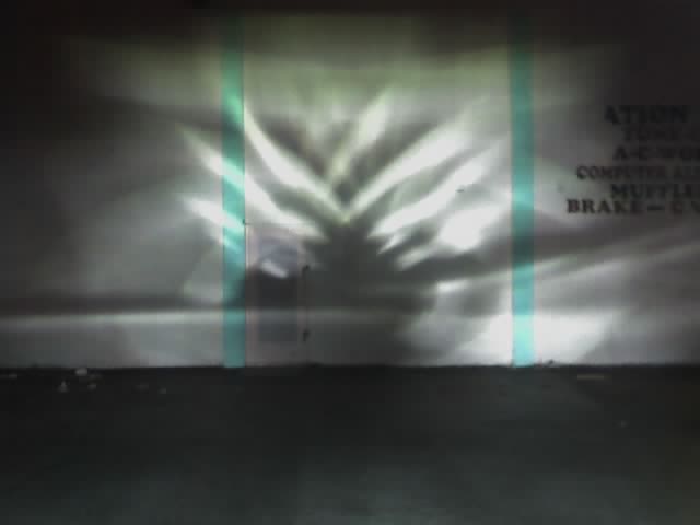

Please dont buy hids unless you have projectors. You will blind everyone on the road if you install them in reflector housings.
This is what proper HIDs should look like
What it will probably look like if you put them in reflector housings
