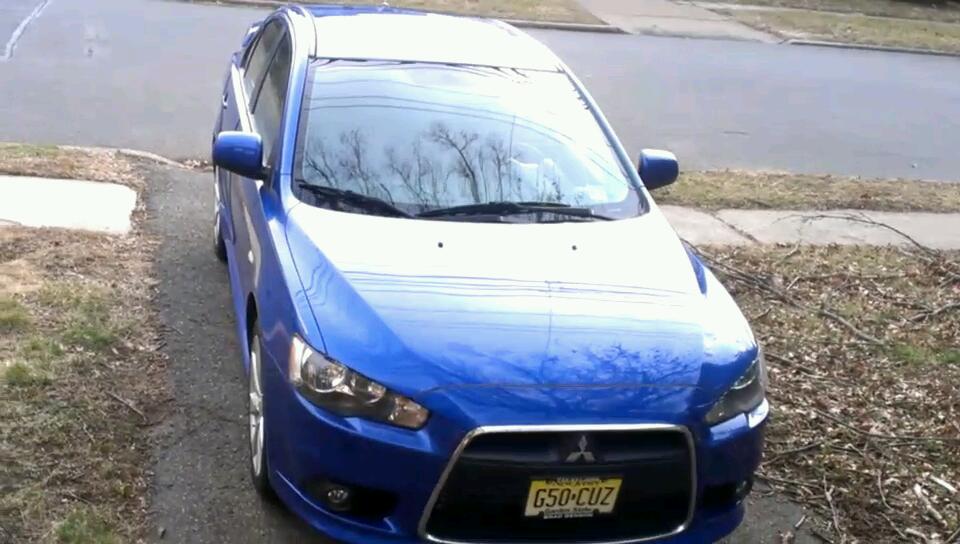

I bought some new fog fog lights made by spec d. I got them to replace the stock ones on my car. But when I went to install them that they do n that they do not fit at all. Spec D's website says they are replacement light that fit on 08+ Lancers except Evo and Rallyart. Has anyone else have this problem and how did you fix it?

Pretty sure the USDM '12 GTS has the ralliart front bumper.
You'll need to get a foglight kit for the RA or 2012+ lancers. 08+ will not fit.

Put up some pics of your car dude, that would be easiest to get the right answer.
chunky9
Posts: 821
Postby chunky9 » Sat Mar 02, 2013 1:53 pm
yeah dude you have the ralliart front bumper
