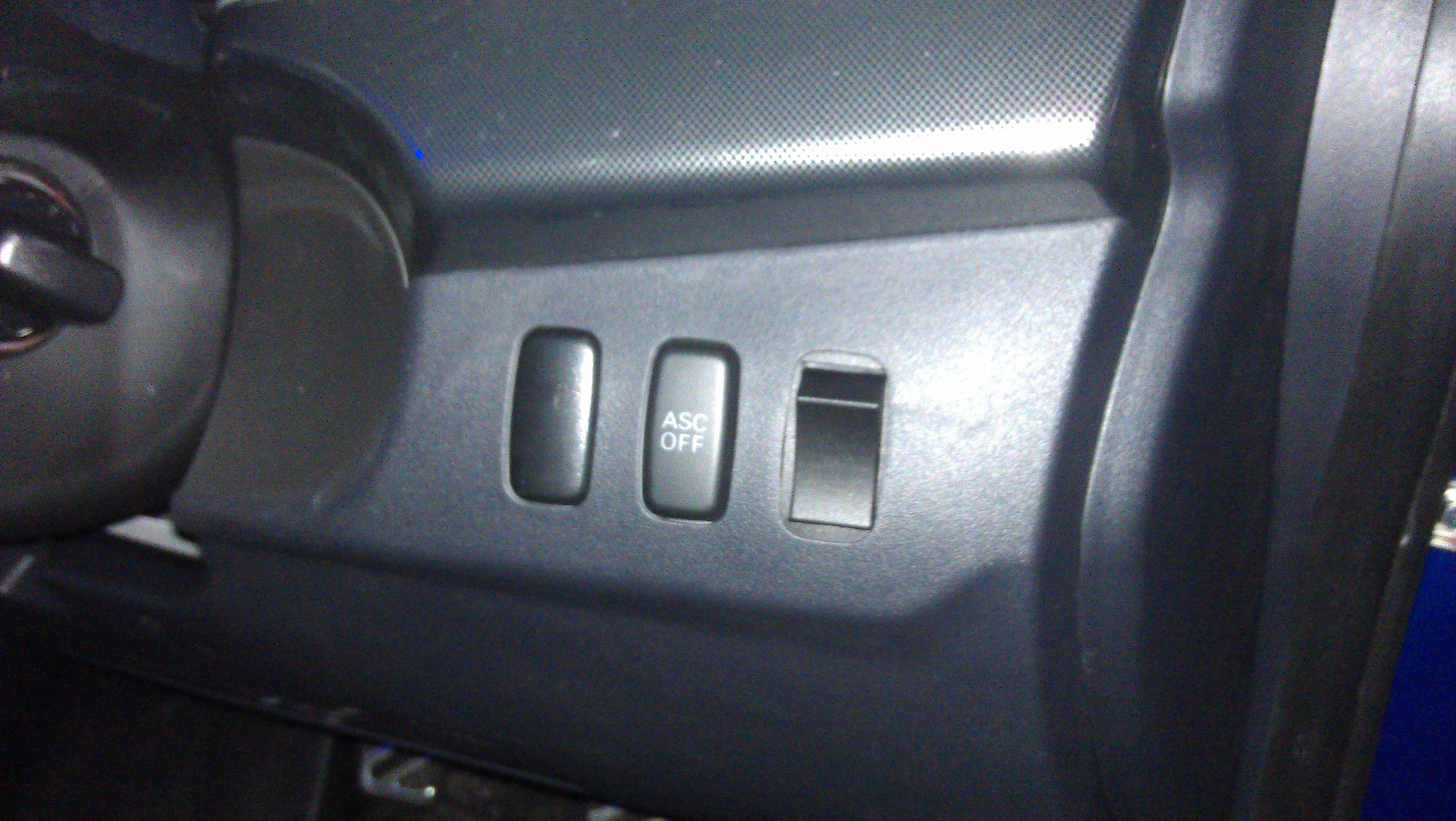

I installed DRLs on my car the other week. I bought a NARVA toggle rocker switch (part number 63040BL) which fits perfectly in the side panel. Ill post a pic up for it. Mine is wired to the cigarette lighter. Hope that helps

Postby Metalstrix » Sun Dec 16, 2012 9:25 pm
Eman014 wrote:[img:4ece344675]http://www.clubcj.net/img/images/1355645170_2012-12-1616.00.39.jpg[/img:4ece344675]
Oh my god! So that's what they can be used for! I was literally wondering what those other two blocks were used for and now you've answered it for me! That's brilliant. I think I'll have that as a switch too! :D:D
