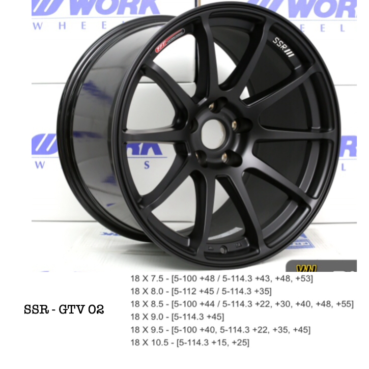

Postby dat-nippa.daz » Sat Aug 12, 2017 9:00 am
Can you guys advise me on the best offset/size for my Ralliart that'll give it a flushed look with minimal rubbing problems please?!?!? (Would like to avoid rolling inner guards as a result of rubbing)
See attached picture for available sizes.
Wheel Brand: SSR - GTV 02
Damir
Posts: 589
Re: **Official Stance Thread**
Postby Damir » Sat Aug 12, 2017 10:53 am
look the lancers cant take big wheels without rolling the guards but your best bet would be 18x8 +35 with maybe minimal tyre stretch to avoid the guards

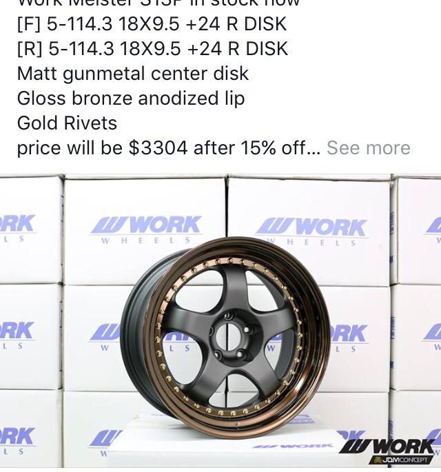

Postby dat-nippa.daz » Sat Aug 12, 2017 6:37 pm
Damir wrote:look the lancers cant take big wheels without rolling the guards but your best bet would be 18x8 +35 with maybe minimal tyre stretch to avoid the guards
Sweet!! Thanks for the advice and also, I've attached another picture of Work wheels that has just landed in oz with size/offset, wat exactly would it take to fit??i.e. guard rolling, flaring, bigger fenders etc
Thnx heaps in advance, I'm new to forums in general and I just bought a 2014 ralliart 6 days ago and any advice would be much appreciated.

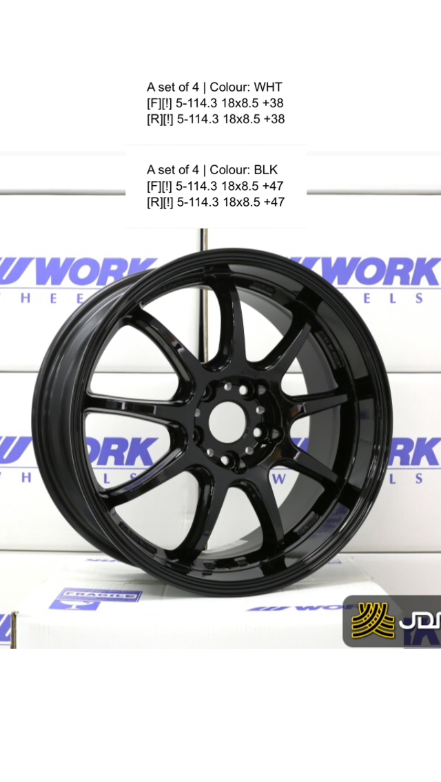

Postby dat-nippa.daz » Sun Aug 13, 2017 1:41 pm
To the Most Knowledgeable member,
Attached is a picture of Work D9R wheels with 2 different offsets I'm looking to get and my question is as follows:
If you had a Ralliart with adjustable coilovers already fitted, wat offset and tyre size would you choose to have the best flushed look without flaring the fenders??
I know rolling the guards to avoid rubbing is probably unavoidable so my only concern is not wanting to flare and respray the fenders.
Thnx in advance, I'm new to forums in general and finding all these posts in clubcj very valuable :)
Damir
Posts: 589
Postby Damir » Thu Aug 17, 2017 3:29 pm
a guard roll for the rears is a must. you might struggle fitting the meisters as they are wide and a moderately aggressive offset.
if you plan to splash out then try and get some rear camber arms (megan racing are the most commonly used around here) and lower the car quite a bit to achieve some natural camber as well.
the d9r with +38 offset will be fine with just a roll
