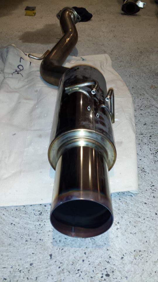

NEW EXHAUST :)
THANKS STEVEN !!!
Also burnt the tip with a propane bottle for the blue effect :P
