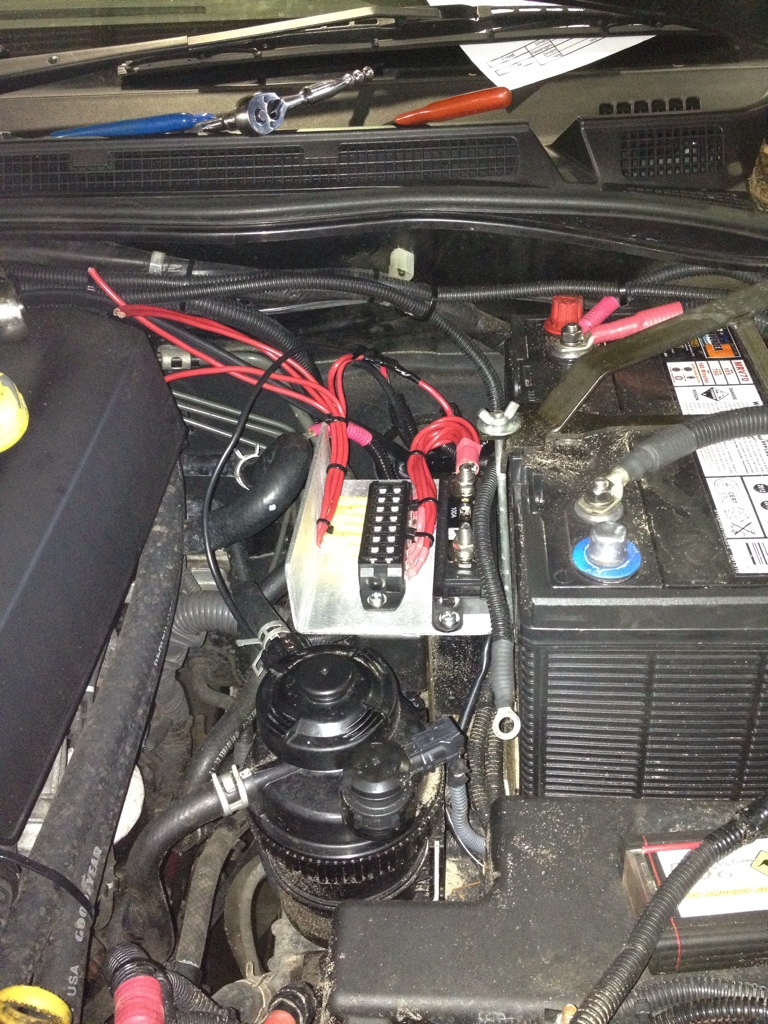

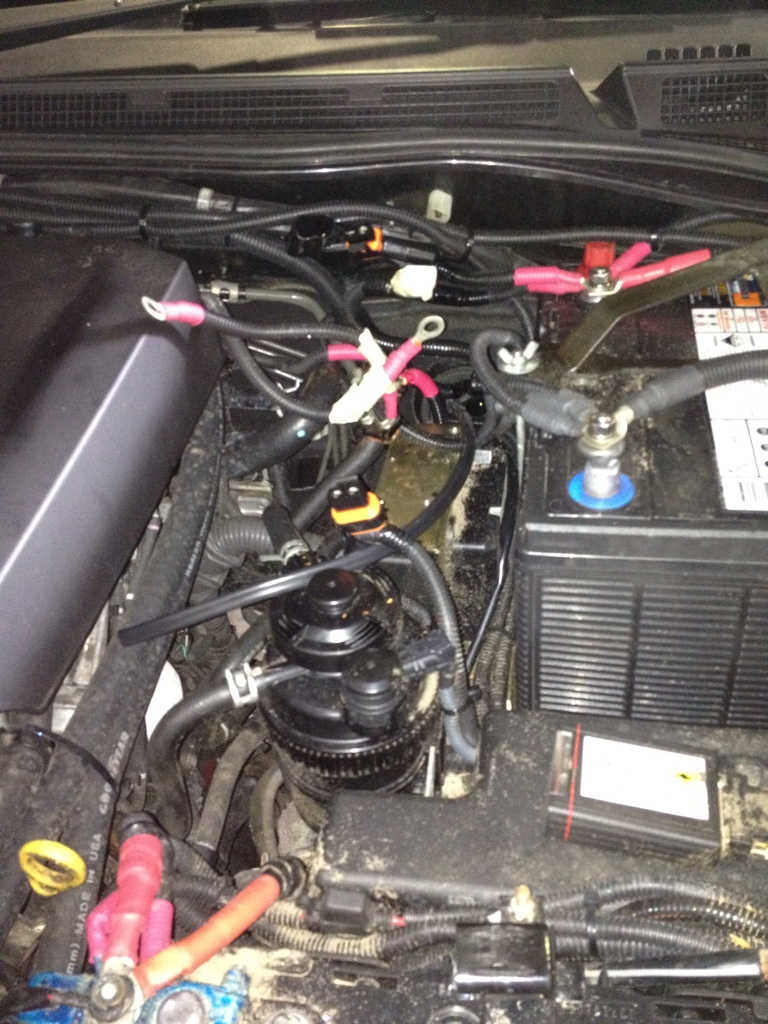

today i continued on with a BIG clean up job on a Hilux that was done by another company and then brought to me to fix the wiring issues.
6 Fuses scattered all through the passenger side of the engine bay and wiring run everywhere.

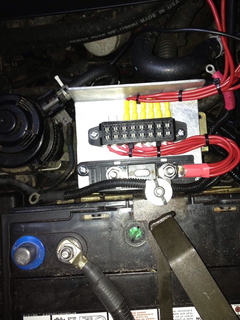

so i fabricated up a bracket for an ANL fuse holder and Fuse Block so all fuses and wiring goes to one location.
And from above

Postby bunnishiwa » Thu Sep 13, 2012 8:51 pm
That's some tidy looking work there matt
