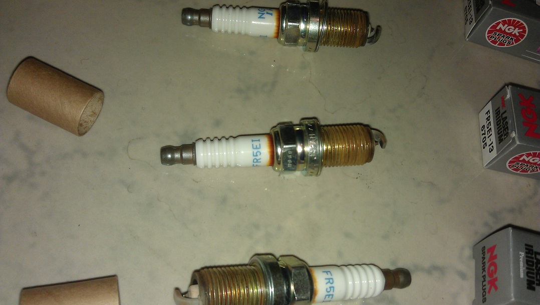

Thought I'd share....
I replaced my spark plugs at 45,000km a couple of weeks ago...
I know it's not needed as the Iridiums have a service life of around 100,000k - but I got them at a 20% off sale ages ago at a cost of around $8 a pop, so no biggie.
The brown ring on the ceramic insulator is "normal" to an extent, tho i'm not sure it should be that much on 45,000kms :shock:
You can see the firing electrode tip end looks fairly clean, a small amount of deposit on it. The needle tip looked fine also the flat bit had some deposit but a groove indicating that any spark would have "contact" between the needle point and the metal conductor.
You can see some of the deposits falling off from the 2nd spark plug in the last two photos... :)

Mine were almost identical when they came out too...

Postby The X » Wed Aug 08, 2012 9:09 pm
No Mitch, I think they do them at 90,000 as the spark plugs from factory are the same NGK Iridiums i replaced them with and they have a service life of 100,000k.
I guess closer to the 100,000k mark they carbon build up is more and inhibiting the quality of the spark.
Being they are such a low cost item, i swapped them out myself at 45,000. A nice clean quality spark can't hurt. :)

Postby The X » Wed Aug 08, 2012 9:17 pm
As long as you use the correct spark plug with the same heat rating and gap distance, no warranty issues. Nothing wrong with going above and beyond the scheduled service requirements.

Wish I had taken photos of mine when I changed them at 80,000..
Yours look clean and almost new compared to how mine came out...
