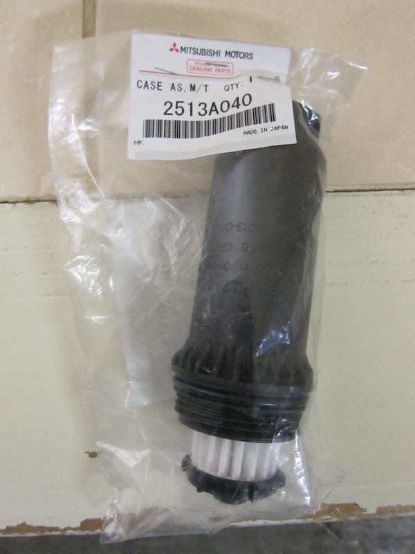

2513A040 Case ASSY-M/T Case Oil Filter
RRP=A$181.00+
CCJ=A$175.00
Rebate ~ A$235+
Details:
Made by IBS Filtran
Here's the part on their webpage! It's the 2 bits on the right of screen.
So here's the markings I see on the thing:
Filter:
IBS Filtran PA66 GF30
7M5R-6K870-AA
Sleeve:
7M5R-6C631-AD
And guess what?
I found one here.
Seems it also goes on :
skrzynia 6-biegowa Powershift
- Focus
- C-Max
- Mondeo
- S-Max
- Galaxy
roczniki po 2008 r.

Good work Ofey, I think ford is a major shareholder in getag so maybe these filters would be cheaper through ford?
chris851
Posts: 255
Joined: Wed Oct 06, 2010 9:51 am
Location: Mawson Lakes
Postby chris851 » Wed Jun 08, 2011 3:02 pm
Just send off some email's to some ford dealers in Adelaide for the Case ASSY-M/T Case Oil Filter ... First response
Hi the filter you are after is $129.47 and would have to come from Melbourne it would need to be pre paid before I can order it I have assumed it is an LV focus
Steve Hart
Spare Parts Manager
Rebel Ford
129.47 is getting better i send a photo of it to him so this should be the same part

Are they asking 31 euros for the filters on that site??
chris851
Posts: 255
Postby chris851 » Wed Jun 08, 2011 5:03 pm
It's Polish Zloty on that site... 40.0375 AUD
Just asked if they will ship 5 of them to oz.
115.00 PLN = 40.0375 AUD
Polish Zloty Australian Dollar
1 PLN = 0.348152 AUD 1 AUD = 2.87231 PLN

Postby chris851 » Thu Jun 30, 2011 9:20 am
shipping info
Hello,
Yes, I can send.
Shipping 100pln for 5.
best regards
Tomasz Michalak
____________________
www.ford.sklep.pl
gsm.: 793 22 23 23
tel.:   61 814 27 78
gg.: 33656098
I would def be up for a group buy? 2 each we might be able to get that cost down even more...
