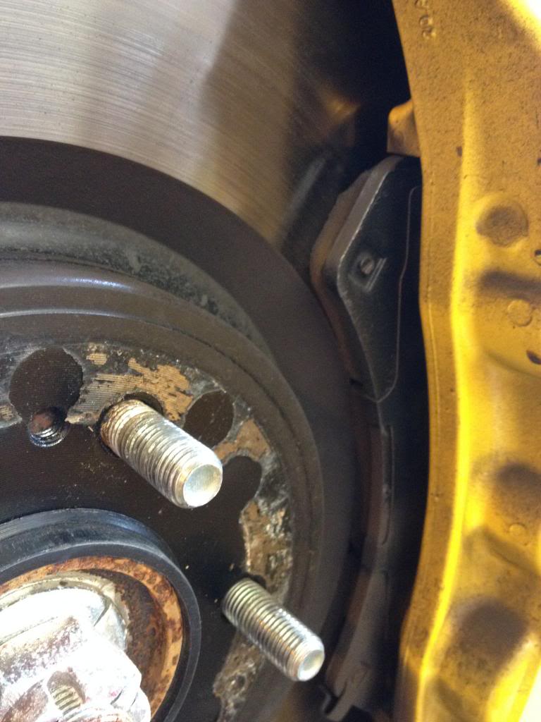

Rob I think you raise some good points here. When you refer to the pad overhang are you talking about this pic:
This is a pic from the newest Ralliart BBK kit that I posted about earlier. You can see that it appears there is a small amount of pad contact in the middle of the pad. If you look at the shape of the pad it seems like the diameter of the rotor isn't quite matching that of the pad. It doesn't look like a lot, but does that matter? I don't know I'm not an engineer. Whats the main danger of a bit of the pad cracking and falling off? It going between the pad and rotor, and not allowing full contact, and therefore not getting full braking power?

I'm not sure that's the same picture but its a similar issue the contact area should sweep the whole pad so the pad wears evenly a thin ridge on the pad would be prone to cracking.
