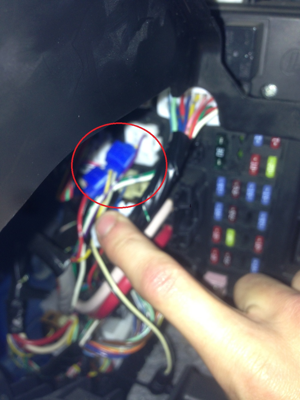

i put some universal LED's into my footwell but they are not turning on , i have found the dome light plug and i have connected all the wires up using some connector things .... not sure of the name can u tell me where i have gone wrong - follow the red circle thats what i have done
thanks sorry to be stupid i dont know much about electronics

Have you earthed your negative wires from the LED's?
If you want them to always be on (when the power is on) earth them to anything metal on your car.
But for an extra something you can do what I did...earth them to the door sensors so they only come on when you open the doors.

Postby SIX » Wed May 22, 2013 8:32 pm
i want them to come on when the dome lights come on ??

Postby Cammo00 » Wed May 22, 2013 11:54 pm
I have mine set up like you want yourse. Cant remember hoe i did it.
Think there is a black wire on the passanger
B PILLAR then the other wire goes to a always live power.
Tgat way when the interiir light turn on they all turn on.

Damir
Posts: 589
Postby Damir » Thu May 23, 2013 6:16 am
check for faulty connections and that the leds are not broken, also check that the earth is on thick enough metal, that sometimes is the cause. My underglow didn't turn on at the front due to a bad earth.
